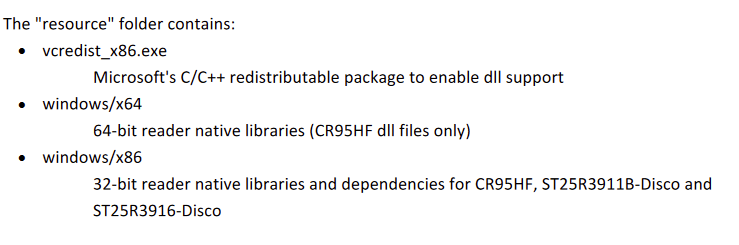

I'm trying to use the ST25 java SDK. The software_guide pdf document says I need to load in my IDE the natives libraries the SDK will need. It says I will find them in t \readers\st\resources, but in this folders there is only windows/x86 for the DLLs, and no windows/x64 as is mentionned in the document. And I can't use the 32bits version in my 64bits JVM. Am I missing something, or did the x64 folder was forgotten in the release ?
Extract from the pdf guide :

Thank you for reporting this error. There should indeed be a windows/x64 folder in the release package.
Note that amongst the ST reference readers, only the CR95HF board is supported in 64-bit configuration as of today. For other readers, such as ST25R3911B/16, etc., you will need a 32-bit JVM.
Please find attached the 64-bit dll files for Windows and the CR95HF board.
This folder will be added in ST25SDK release 1.10.3.

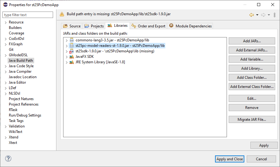

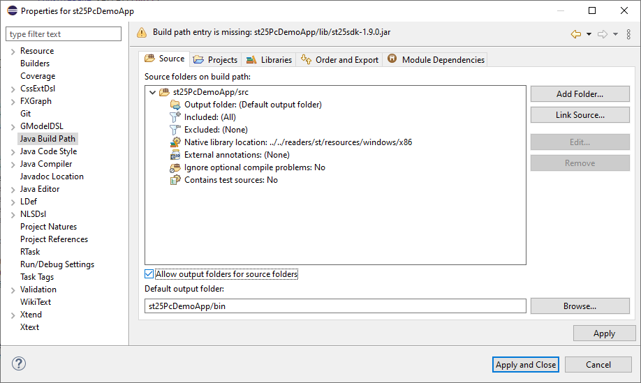

Make sure you indicate the path to the reader library in your application's Java Build Path as shown below:
As a reminder, the dll path should be indicated in the Source tab of the Java Build Path

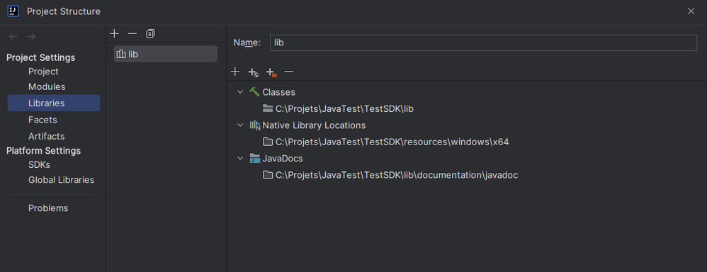

I am using Intellij Idea, and not Eclipse, but I believe I set up both the dll folder and the jar folder right, but I still got that same error.
The lib folder contains :
And the resources\windows\x64 contains the folder you sent earlier
