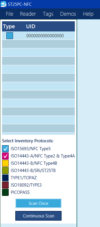

I'm working with a ST25DV64K-JFR8D3 placed on a custom PCB and very rarely facing a weird issue, namely the UID response of the chip becomes 0000000000000000.
This renders the device completely unresponsive, as no RF communication can be performed to it.

After checking some things based on the suggestions above I was able to diagnose the cause of 00000000 UID response.
The problem was bad soldering - the LPD pin under ST25DV was poorly connected to the board (was basically floating).
