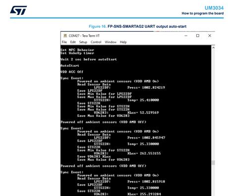

This is the user manual expected output

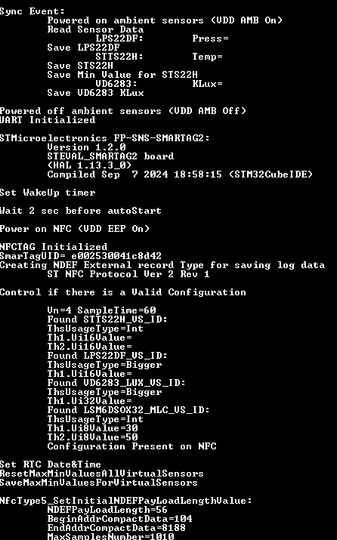

Where as this is my result
Would appreciate if anyone have prior experience can give me some direction.

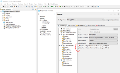

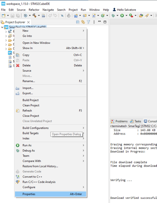

To solve the issue, open the project properties
check the indicated boxes and re-build the code
