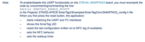

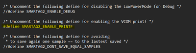

Edit: I tried the steps (see below) in the manual to enable the UART by removing the "//", but I get no info/data in the Tera Term application after I press reset on the Smarttag2. What am I doing wrong?

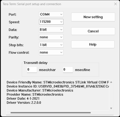

See the Quick Start Guide to enable/disable the UART logging functionality. Make sure that the sources are recompiled after uncommenting SMARTAG2_ENABLE_PRINTF define (i.e. make sure Firmware_conf.h has been saved to the disk before compiling). Check the USB cable and the serial port setting (115200,8,N,1).

Thanks for your reply and the link to the guide! I was able to perform Step 1 and flash the pre-compiled binary and thereafter able to add the Smartag2 via NFC in the ST Asset App. But in Step 2 I did not have any further success as I still have issue with showing any text in Tera Term when pressing Reset on the Smartag2. The port setting is correct, I have uncommented the SMARTAG2_ENABLE_PRINTF define text and saved. Does the FP-SNS-SMARTAG2 folder have to be in a specific place?
2024-08-30 1:23 AM - edited 2024-08-30 1:25 AM
I apologize by advance if my question is naive: have you recompiled the firmware and then downloaded it to the board after uncommenting SMARTAG2_ENABLE_PRINTF? Have you followed the instruction from "How Install the code after compiling the project" (slide 12 of the Quick Start Guide)

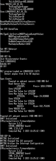

I tried again and now the log/text would show in Tera Term! The issue was that both programs have to be opened at the same time, as when I program in STM32CubeProgrammer it displays the log in Tera Term. Before I would program, close CubeProgrammer and then after open Tera Term and press "Reset" on the SmartTag2 where nothing happens. Because it says "When you first press the reset button, the application", this only works when I have both programs open and I program (at least for me).

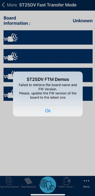

I am suppose to be able to press Reset and the User button (https://www.st.com/resource/en/product_presentation/fp-sns-smartag2-quick-start-guide.pdf) on SmarTag2 in order for FTM to start and FW-update, but nothing happens. I also tried in the ST NFC app, but it says I need to update the FW version.

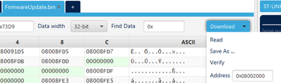

make sure to flash SimpleBootLoader.bin at the standard boot address (0x08000000), then flash FirmwareUpdate.bin at 0x08002000:
Disconnect the flash programmer. Press the reset button on the board.
Wait few seconds. Once the following message is displayed "NFCTAG Written the Interrupt Configuration", press the USER button and wait for "Starting FTM" and then "Started FTM".
It should be then possible to update the FW with the ST25 NFC App.

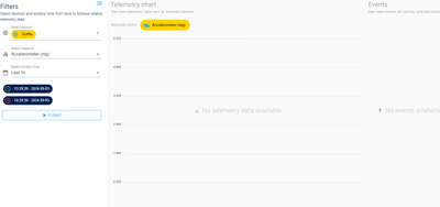

I have been able to log data in the ST Asset app and upload to the Cloud/website account, but I am not able to see any acc data on the web, do you know why? Acc data logs in the app while temperature and pressure show in app + web.
