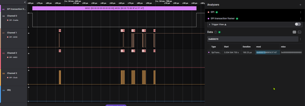

in above trace it was getting to RFAL_NFCA_CR_SEL_TX with the NFC-A tag. I understand that it will not be easy for you to debug our driver logic. But what you could still do is debugging the SPI driver calls (using logging) vs the bytes observed using logic analyzer.
I assume you will need to first improve the signal quality as observed on the logic analyzer and then look at the data bytes. Ideally you could straight look at the unique pattern as above which was present in both traces.
If this is not possible then I think it should be possible to use a diff tool to see differences in logic analyzer output (exported/sent to terminal) vs logs which you could add to your SPI driver.
Good hunting!
Ulysses

can you connect a logic analyzer on SPI (CLK/MOSI/MISO/CS) and IRQ_3916 and provide the trace when you try to poll the tag.

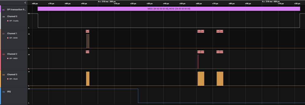

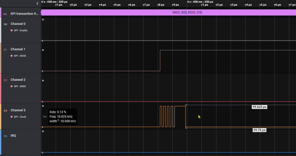

I added saleae analyzer output for working/not working device

2022-11-14 8:12 AM
I reviewed the traces (also downloaded and enabled the SPI transaction framer).
Reviewing the traces I see not soo good signal quality on the signals:
I also recommend to look into signal integrity - shorten your flying wires. Twist the wires and move away perpendicular to the antenna.
Best Regards, Ulysses
