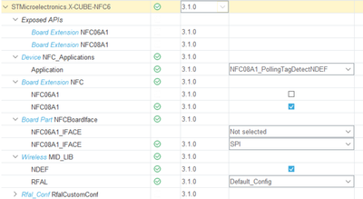

2025-05-20 3:07 PM
make sure to properly configure the components:
and then:
This should generate the NDEF application.
Rgds
BT

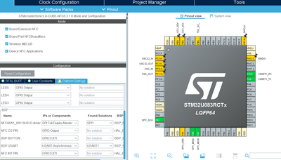

2025-05-26 1:21 PM
Hi Mihai,
On my side, no compilation issue:
Make sure to have the following configuration for the Bsp:
I've attached the ioc file that I have used. Just compare with your ioc.
Rgds
BT

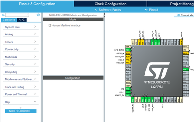

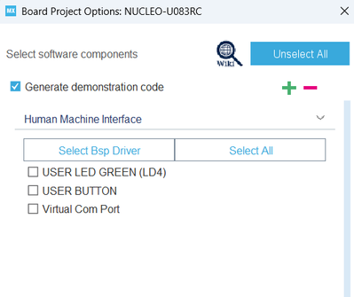

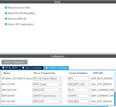

2025-05-27 7:39 AM
Hello BT,
Yes, you are right SPI is by default use, for I2C hardware changes to the expansion board are needed.
I knew that but somehow I generate it by mistake for I2C in the project I was referring.
For the picture above I have "No solution" for HAL_EXTI_DRIVER and BSP_COMMON_DRIVER(for USART).
Am i missing some components to check in for CubeMX ?
Thanks,
Mihai
2025-05-27 7:45 AM
like this:
