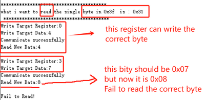

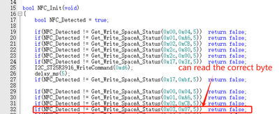

At the beginning of the program,

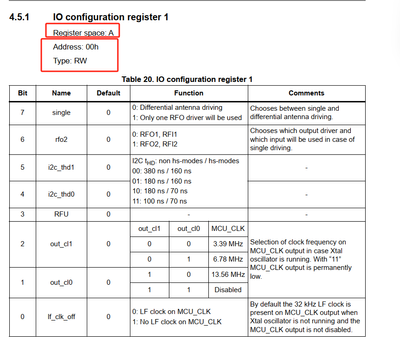

I first performed a write-then-read operation on register 00 using I²C timing.
I wrote 0x04 to register 00, and this worked correctly.

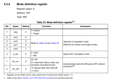

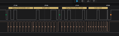

However, when I used the same method to perform a write-then-read operation on register 03,
I wrote 0x07 to register 03,
but when I read register 03, the returned value was 0x08.
Can you tell me why this problem might occur?
What are the possible reasons?

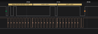

Even though I wrote 0xFF to register 0x03, the value read back is still 0x08.
2024-09-29 1:38 AM

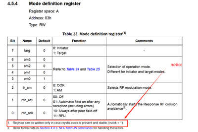

I found out why.
so i should init first:
