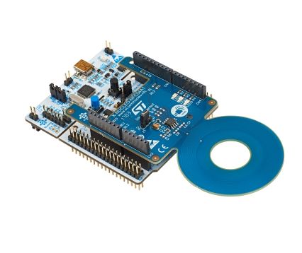

I changed hardware setup. right now i got X-NUCLEO-NFC04A1 board and android phone with st25 nfc app. I need to write the reader data to tag eeprom and then to the i2c interface like you said. I need some help materials or tutorials .
Thank you
with regards
vignesh raj
2020-06-23 6:22 AM
for the X-NUCLEO-NFC04A1, a firmware package with examples is available on st.com (see X-CUBE-NFC4 package and UM2239 User Manual).
For the ST25 NFC Tap app, see the MEMORY tab for the various Read/Write/Dump features.
