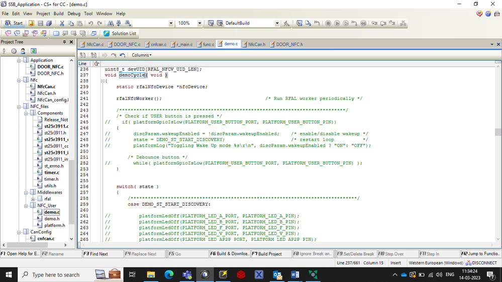

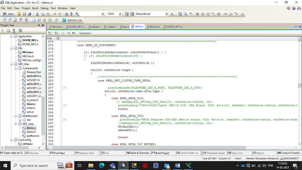

This is inside democycle() function ,
Here in RFAL_NFCA_T4T switch case we detect our tag.
2023-03-14 2:50 AM
as written by Brian before: Look into totalDuration which is a paramater to rfalNfcDiscover() and calling rfalNfcWorker() every 100ms will make NFC communication very slow. For NFC-A I expect multiple calls being needed before a tag is anti-collided. Go down to 1ms or even below.
Regards, Ulysses
