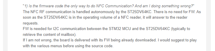

"1) Is the firmware code the only way to do NFC Communication? And am I doing something wrong?"
The NFC RF communication is handled autonomously by the ST25DV64KC. There is no need for FW. As soon as the ST25DV64KC is in the operating volume of a NFC reader, it will answer to the reader requests.
FW is needed for I2C communication between the STM32 MCU and the ST25DV64KC (typically to retrieve the content of mailbox).
If I am not wrong, the board is delivered with its FW being already downloaded. I would suggest to play with the various menus before using the source code.

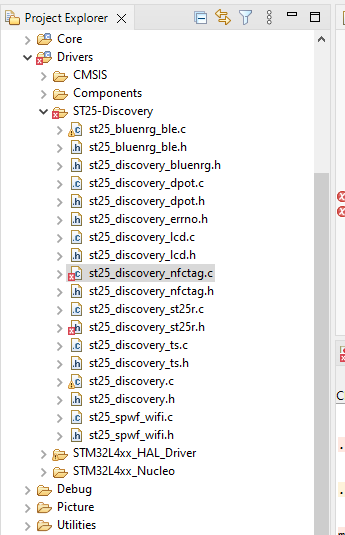

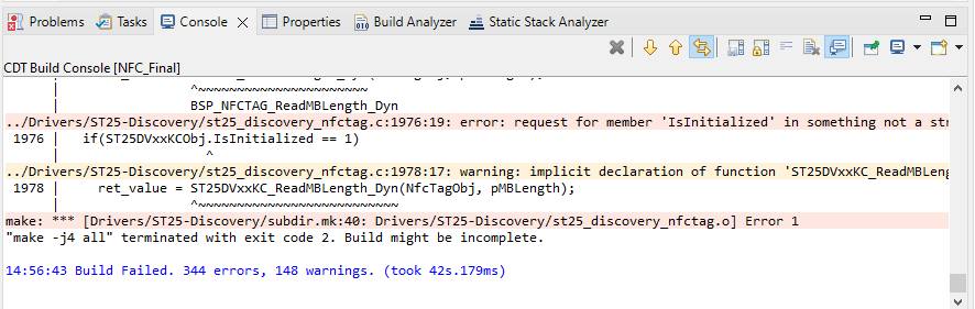

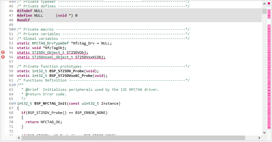

Thankyou for your reply. I downloaded the firmware source code but when I compiled it, I am getting the following error in two nfc source files:
It is not just one error, the whole file is filled with errors:
The file that is causing the error is : (st25_discovery_nfctag.c file in Drivers Package same is the case with st25_discovery_st25r.c file)
Please help me If I can do something to remove these errors.
2023-04-19 4:30 AM
please concentrate on the first few errors reported, not on the last ones. Here it is important to have the complete error message.
