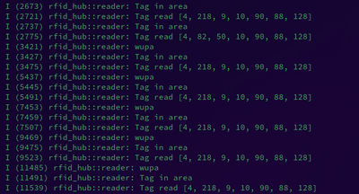

2023-08-18 6:22 AM
6 steps listed is what I do now in Rust library.
Issue is that if I have 2+ tags in field and I do WUPA -> select with anti collision -> get UID -> HLTA -> REQA -> select with anti collision -> no response ( Here I would expect to get next tag UID)
So it seems to me that HLTA put all tags in sleep state.

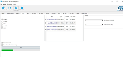

2023-08-21 1:55 AM
I tried with disco board and windows gui software and it seems to run fine.

2023-08-21 6:41 AM
Actually if I replace wupa with field restart it solves my issue.
Here is capture where I keep field on. My tags are already on antenna from the start. First it reads both tags and then just one even after WUPA call
Capture

2023-08-22 1:50 AM
Thanks for the trace. If I understand properly,
In that case, the Field has to be set to the off condition for a duration of tFIELD_OFF (5.1ms) before repeating the UID retrieval.
If you repeat twice the collision resolution activity without a field reset between the 2 collision resolution, the first time all tags will be found (because all tags are initially in Idle state), the second time only one tag will be found (because all tags are in SLEEP_A, then move to READY_A* when the ALL_REQ/WUPA is issued and as soon as a SEL_REQ is sent to a given tag, the other tags returns to SLEEP_A).
