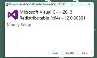

2023-08-23 9:17 AM
I installed Visual C++ Redistributable Packages for Visual Studio 2013 and that didn't resolve the crashing issue. Do you have any other solutions? Thanks in advance.
2023-08-23 9:20 AM - edited 2023-08-23 9:21 AM
vcredist_x64.exe

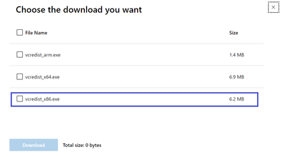

2023-08-24 2:04 AM
as our application is x86's based, can you please try to install vcredist_86.exe.
Best regards,
NFC Customer Support
2023-08-24 8:49 AM
That worked! Thank you for your help take care.
