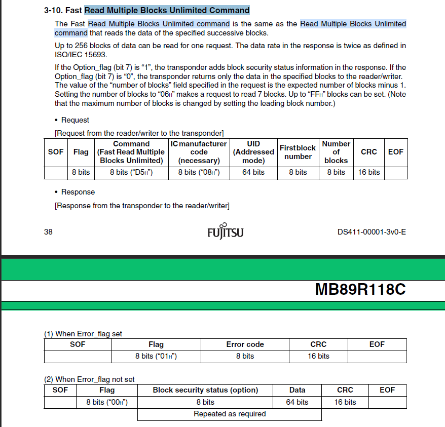

Hi I am trying to implement a custom ISO/IEC 15693 command called "Fast Read Unlimited Blocks" command for the Fujitsu Tag MB89R118C (attached the datasheet). This command allows reading all 256 memory block or 2048 bytes on the Tag's memory in one transaction.

transactionStatus for `nfcvFastReadMultipleMemoryBlocksUnlimited` is ERR_NOMEM.
QUESTION:
What size read buffer should be supplied to `rfalNfcvPollerTransceiveReq` in order to successfully read 2048 bytes in a single Fast Read Multiple Blocks unlimited command?
I am currently passing it a read buffer/ receive buffer of size 2816 with the calculation:
// Read Buffer size calculation for Read Unlimited RFID commands:
// (1 byte Response flags + 8 bytes (per memory block) + 2 bytes CRC)*256
// mem blocks
Is this correct?

Hi SDesa.1,
our RFAL currently limits the frames to ~255 bytes of NFCV frames. Please see the codingBuffer inside rfal_rfst25r3911.c for details. Technically the ST25R3911B does not limit received bytes. But please beware that software is doing the Manchester decoding so the buffer needs to be doubled plus a bit. So you can either enlarge the codingBuffer or see if you decode the received bytes on the fly.
Regards, Ulysses
