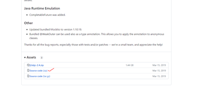

2024-06-05 12:41 AM
Hi Victor,
Sorry for late reply, Just wanted to make sure everything is working fine. We can close this thread as it working fine.
Changing to version 2.4 from 2.8 is resolved the compile issue.
Just wanted to iterate all the steps for people new to IOS.
1. Downloaded IOS NFC tap source code(STSW-ST25IOS001) (Version 7.4.0 )
2.Check compatible version of J2OJBC version(2.4 is compatible for 7.4.0)
2.Downloaded Source code from https://github.com/google/j2objc/releases
3. Goto downloaded folder and Build using command $make dist . It took some time and created dist folder with lib,frameworks,include

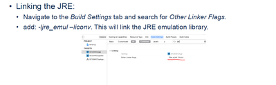

4.Linking JRE also done. Make sure there no inverted colons in path i.e "ljre_emul liconv". Path should look like below.
5. Updated search paths with dist folder.

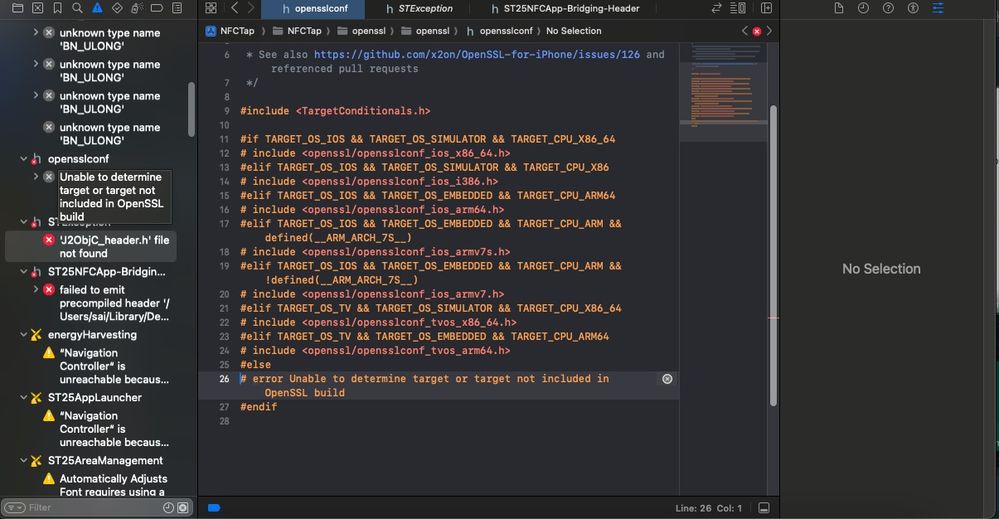

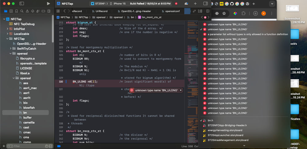

2024-05-22 12:41 AM
hi Suresh,
I redo from clean environment, and all is working fine.
Please, could you check in "bn.h" file in which case BN_ULONG is defined ? THIRTY_TWO_BIT, SIXTY_FOUR_BIT_LONG or SIXTY_FOUR_BIT ?
At my end, I'm using "THIRTY_TWO_BIT".
I have the feeling that none of these are used in your end....
Let me know.

2024-05-23 7:05 AM
I 'm able to reproduce issue only in simulator mode...anyway...
Please, could you tell me which include file "# include <openssl/opensslconf_...." is called in the file "opensslconf.h" ?
#include <TargetConditionals.h>
#if TARGET_OS_IOS && TARGET_OS_SIMULATOR && TARGET_CPU_X86_64
# include <openssl/opensslconf_ios_x86_64.h>
#elif TARGET_OS_IOS && TARGET_OS_SIMULATOR && TARGET_CPU_X86
# include <openssl/opensslconf_ios_i386.h>
#elif TARGET_OS_IOS && TARGET_OS_EMBEDDED && TARGET_CPU_ARM64
# include <openssl/opensslconf_ios_arm64.h>
#elif TARGET_OS_IOS && TARGET_OS_EMBEDDED && TARGET_CPU_ARM && defined(__ARM_ARCH_7S__)
# include <openssl/opensslconf_ios_armv7s.h>
#elif TARGET_OS_IOS && TARGET_OS_EMBEDDED && TARGET_CPU_ARM && !defined(__ARM_ARCH_7S__)
# include <openssl/opensslconf_ios_armv7.h>
#elif TARGET_OS_TV && TARGET_OS_SIMULATOR && TARGET_CPU_X86_64
# include <openssl/opensslconf_tvos_x86_64.h>
#elif TARGET_OS_TV && TARGET_OS_EMBEDDED && TARGET_CPU_ARM64
# include <openssl/opensslconf_tvos_arm64.h>
#else
# error Unable to determine target or target not included in OpenSSL build
#endif
