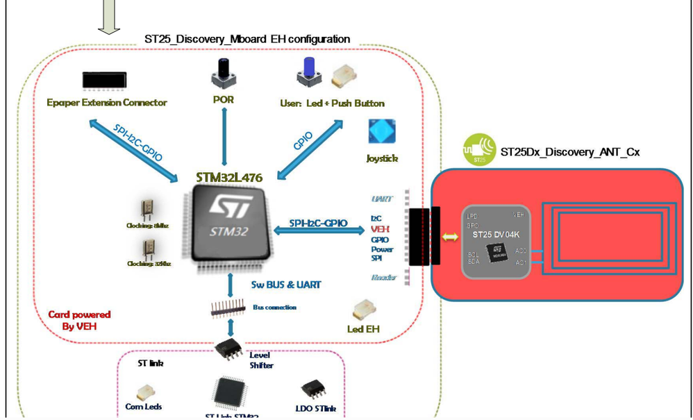

I have seen that ST25 Discovery MB1396 can use EH energy of ST25 to power L4, why can't I use NUCLEO of ST25DV? Is it possible to achieve wireless power supply for MCU?
