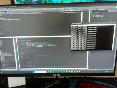

My first steps were to use the library's polling example to do an initial anchoring test between the tag and reader, which worked well. My current goal is to expand the polling example to work better with Energy Harvesting, and thus achieve higher voltage measurements to consolidate the idea of powering chips with it.

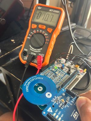

I made an improvised measurement on the EH pin of the x-core while it was running the polling example on the NFC12A1 x-core, to get an idea, and I reached 10 mV on the EH pin.
What can I do to increase this to perhaps 1V, for example? Would it be possible to reach 3V in EH?
From what I've seen, it's possible to adjust the transmission power of the ST25R300, but how can I do this in RFAL and STM32CubeIDE?

You should already get more than 10mV on EH with the standard ST25R300 setting (I'm expecting some Volts not mili-Volts). So, I guess there is something wrong to fix before trying to tune the reader.
How and where do you measure EH?
How did you enable EH in the ST25DV04K? (it is disabled by default)
Best regards.
Hello! Thank you for your reply.
Yes, I activated EH. I am not using RFAL in the TAG system because I have a very large space limitation in the MCU. But my current configuration saves the active EH status from the ST25DV EEPROM.

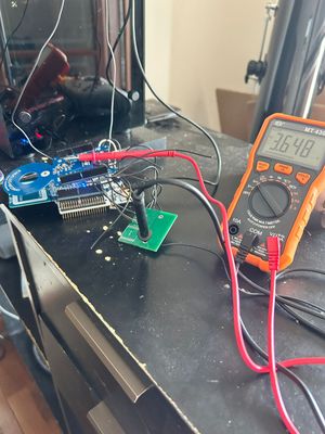

Are you enabling the EH from the static register (EEPROM)?
I think the ST25DV_EH_Enable_Static function is wrong. It looks like to me that it is setting bit 0 (EH)_EN) of static register EH_MODE to 1 to enable EH. If you look at the datasheet table 40, it must be set to 0 to enable EH. Actually, it is a bit of a trap as this bit is reversed compared to the EH_EN bit in the EH_CTRL_dyn register.
Best regards.
Thank you! I ended up overlooking that part. In addition, using an example such as polling in Reader made my field variable, which caused instability in reading. Now I have a value of 3.6V using X-Nucleos, and in the next steps I will implement it in my custom tag.
