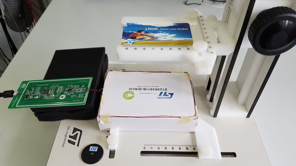

I did a little proof of concept. I connected a 14x10cm 2 turn wire wound antenna to a ST25R3911B-DISCO board and measured the read range with several tags. The antenna inductance is around 1.7µH. The antenna has no middle GND connection.

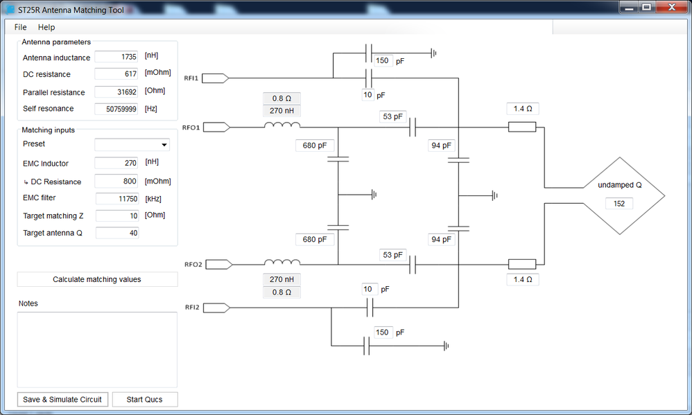

Thisare the inputs i did in the ST25R Antenna Matching Tool:
Besides the measured antenna parameters i have chosen my EMC filter settings and target matching impedance and target antenna Q.
The presets define matching inputs for a special purpose. VHBR has data rates up to 6.5mbit and therefore requires very low Q-Factor. EMVCo only requires 106kbps therefore a Q-Factor around 25 is suite able. ISO15693 even has lower data rates. Therefore we can further increase the Q-Factor.
The matching impedance defines the power transmitted towards the antenna.
Since we want quite some output power i have chosen 10 Ohm matching impedance. Since ISO15693 is quite relaxed on rise and fall times i have chosen a target reader Q-Factor of
This was then my reader setup:
This are the followingresults i got:
Tag type read range [cm]
LRi2K (ID1 8.5 x 5.4 cm - picture) 24
ST black coin (3cm diameter - picture) 21
ST25DV_Discovery_ANT_C5 (4.0x2.2 cm) 20
I did some tweaking on the receiver settings (AM only, 1st level gain set to boost). also due to the high output power it was necessary to bypass the internal Vsp_RF regulator (connect pin 9 to VDD). V_RFI was adjusted to 2.7Vpp. For the EMC filter i have chosen low DCR, high Q coils.

The V_RFI is the antenna voltage applied to receiver. This voltage is divided down by C401:C402 and C411:C412 (UM2042, page 13). The V_RFI should not exceed 3Vpp. Due to component and PCB tolerances 2.7Vpp is recommended. Depending on the Q-Factor the antenna voltage is typically between 20Vpp and 70Vpp - higher Q gives a higher antenna voltage.

Ok I get it, with the capacitor voltage divider you placed, 10 and 150pF 3Vpp would be an antenna voltage around 48V, right? I guess I have a last question, how do you measure the antenna voltage? I get how you calculate the Q factor with the results from the VNA, but not the voltage.

I ended up with something like 10pF : (220pF + 33pF). Which means something like ~ 68Vpp on the antenna.
This voltage may be too big for using AAT (25Vpp trim pin limit). Therefore you either place a capacitive voltage divider instead of each trim capacitor or you disconnect AAT.

10Ohm target matching Z
40 Target antenna Q
As I know I would get high antenna voltage, I did not connect AAT on my test board.
The antenna calculator gave a 10/150pf voltage divider for RFI which I followed for the test board.
After assembly, the board works, but I have 90Vpp antenna voltage, which leads to 5.6V on RFI pins. I was surprised to see it was working while being above the 3V range.
If my calculations are correct, I need to replace the 150pf by a 350pf capacitor to bring down the RFI voltage to 2.5V.
