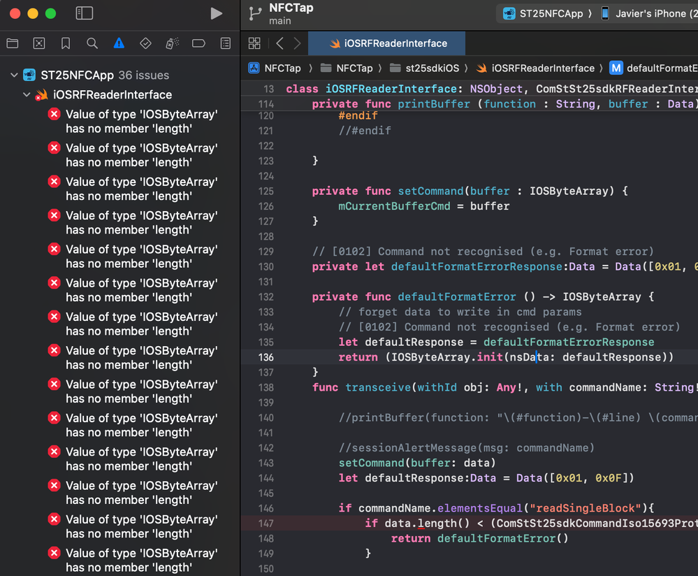

I'm trying to compile NFC Tap for iOS but no luck so far. I've resolved the following issues, by following the advice of other posts on this forum:
After these fixes, the project still fails to compile due to the errors shown below. I'm suspecting an issue with the j2objc version. I'm using the latest from their repo. Is there any recommended version that I should use?
Xcode Version: 16.1
STSW-ST25IOS002 version: 7.6.0
STSW-ST25IOS005 version: 1.0.0
Thanks!

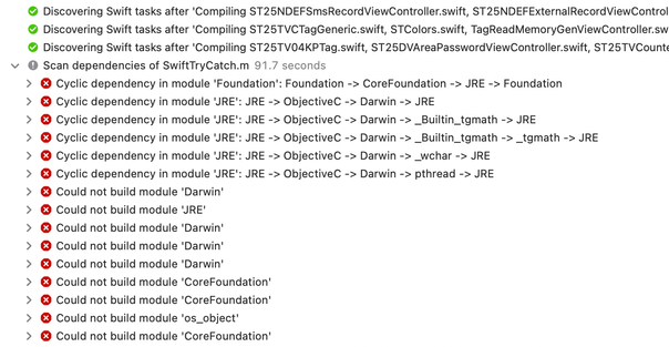

With these I got past the errors from my original post. Now I'm struggling with this:
I'm tweaking the search paths of the include files, but so far no luck. Any suggestions?
Thanks!
Javier
EDIT: Additional detail on the specific include files below:
2025-02-04 5:40 AM
Getting there inch by inch...
The cyclic dependency is fixed by making the j2objc search paths non-recursive. That is:
- "$(SRCROOT)/st25sdkFramework.framework/Headers/**",
+ "$(SRCROOT)/st25sdkFramework.framework/Headers",
+ "$(SRCROOT)/st25sdkFramework.framework/Headers/Jre",
So compilation now completes successfully. Now dealing with a linking error...

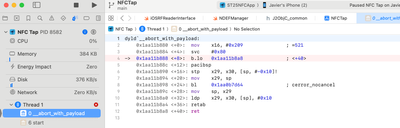

Oh, just removed -ljre_emul from the linker flags, and the app builds. Great!
The app starts running on the phone, I see the splash screen... and the it crashes:
So close...

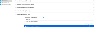

2025-02-04 7:12 AM
Yay! Finally got it to run. I had to add an extra build step to embed st25sdkFramework into the final bundle. (Project -> Build Phases -> + -> New Copy Files phase -> Rename to "Embed Frameworks" -> Destination "Frameworks" -> st25sdkFramework.framework

Just one minor comment : why do you need to define J2OBJC to `$(PROJECT_DIR)/Frameworks/st25sdkFramework.framework` ? Normally, we shouldn't use anymore J2OBJC varaible with framework.
In addition, I guess you forgot to embed framework in your app at the beggining. This could explain why you must
Yes, I thought that by dragging a Framework into the project, Xcode would take care of that step for you. I guess it does not.
