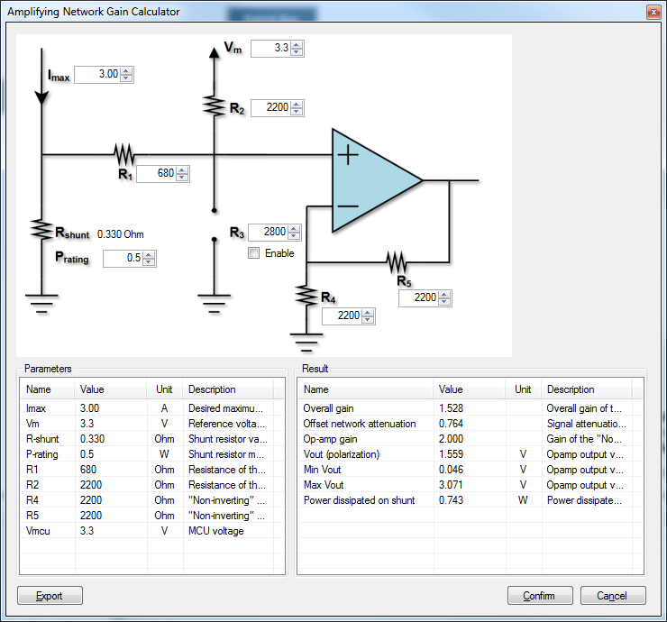

The gain is 1.528 and the offset voltage is 1.56 V.
You can also use the the MC Workbech to calculate it: Power Stage --> Current Sensing --> Calculate button
