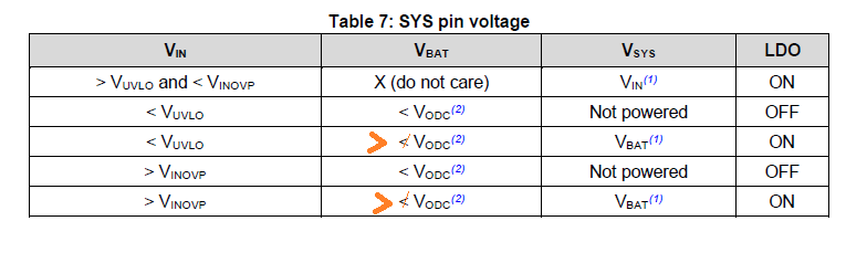

I also checked the operating condition table in the datasheet. It is kind of weird for me. Because if the voltage of the battery is in the valid range (3 ~ 4.2 v) it never switches to the battery. I think the table should be modified as below.

the behavior you are experiencing is correct . If you connect a charged battery the device stays in shipping mode. To exist from shipping a valid input voltage must be connected and the battery voltage is higher than VODCR .

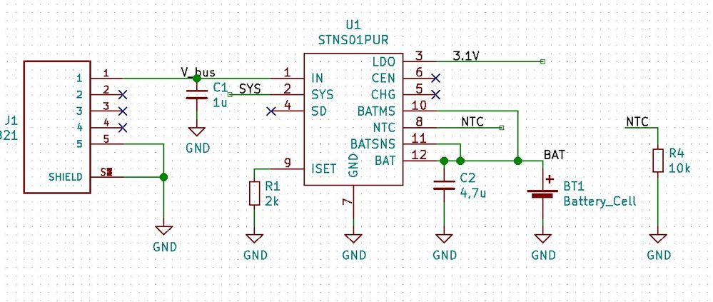

Here is my schematic:
My system is designed to get power from SYS pin. Everything is fine when USB is connected so I can debug my program. The battery is charging. But when USB is disconnected, no more power on SYS pin.
Could my connection between BATMS and BAT cause that? I figured out this connection is useless today. But I don't know if it can cause problems.
