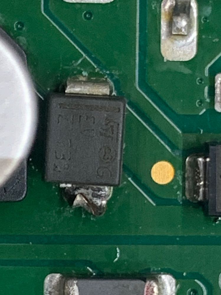

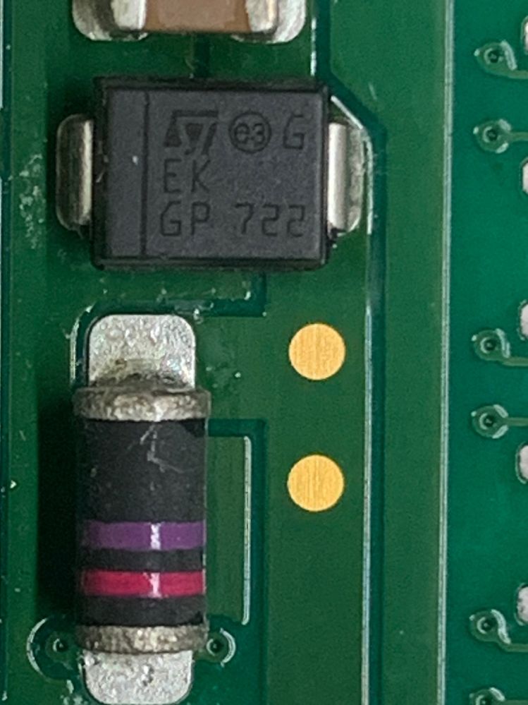

Please refer to the attached image.
2022-11-06 4:20 PM
e3 e4 relate to the plastic, lead frames, etc.
ST DIODE EV SM6T36A
ST DIODE EK SM6T22A
