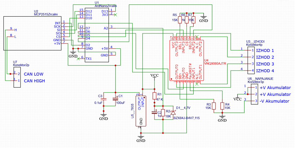

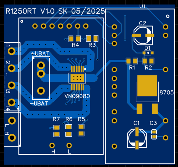

Hi all. I've made a dedicated PCB that should control auxiliary lights of my motorcycle. I use CANBUS information by MCP2515 module and using Arduino Nano digital output pins to directly control input pins of VNQ9080.
I assembled all elements on the PCB and tested the product by improvised wire connections to the connector holes. All worked as expected. I connected a connector ( a lot of curving copper wires to make it possible to install the device in a small plastic box) and installed all in the plastic box. I checked all connector points for eventual shorts with Fluke 179 ohmmeter. Everything looked well and I connected the product to my test wiring as before. What a disaster! My LED lights started blinking,... I found out that output pins delivered only about 3V instead of full battery voltage. I imagined that I have ruined the VNQ by applaying wrong voltage when tested with ohmmeter - Reverse Vcc is specified as 0.3V

For better readability (not all community users can or want to read DOCX files), I took the trouble to insert the schematics and your layout as images.
Are you sure that the tab of the controller (labelled with a typo 8705 in the layout) is connected to GND, as no via is visible?
A reverse measurement with the ohmmeter does apply a voltage of a few volts to the device, but this is usually current-limited, so that the voltage collapses and should not destroy the device. However, a more accurate statement can only be made if the parameters of your ohmmeter are known. Assuming that the VNQ9080AJ was not soldered on upside down, I would assume that you handled it incorrectly and destroyed it, e.g. by not taking sufficient care with regard to ESD protection.
As for the permanently switched-on output, we can only speculate, as you have not specified exactly which one it is. If it is OUTPUT3, for example, you may have accidentally caused a short between pins 16 and 17.
