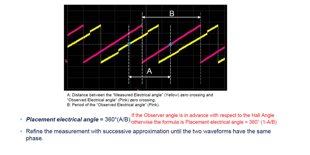

Once it is done, you need to properly configure the placement electrical angle.

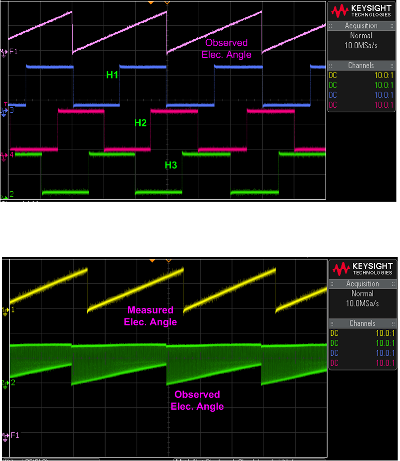

With the MCSDK 5.Y.2, and your project with the Hall sensors as auxiliary sensor, you can view the electrical angle coming from both algos STO-PLL, and HAll sensors. (even if only the STO-PLL is actually used to control the motor)
The both sawtooth must be superimposed. The shift between them is controlled by the placement electrical angle parameter.

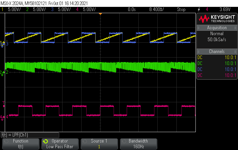

I use 5.4.7 version. Yellow curve is the observed elec. angle and green is the measured electrical angle, However it is difficult to observe the elec angle measured by Hall sensor.

0693W00000FBAwmQAH.pngThis is the curve you should observe.
On 5.4.7 it can be observed with the DAC only.
From your picture, the first thing is that your both curves are opposite, This means that your Hall sensors connexion are not Ok.
The second point is that your observed angle go back to 0, could you print your three hall sensors signal ? I wonder if the three sensors toggle correctly.

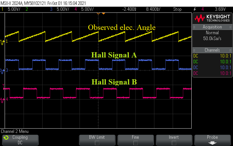

Since from the previous result, both measured and observed elec. angle are opposite. I changed Hall signal 2 and 3, now the measured and observed elec. angle are in right direction. I measured in both positive and negative direction to see the difference.
in DAC channels, i think Channel 2 is damaged. The signal is not ideal.

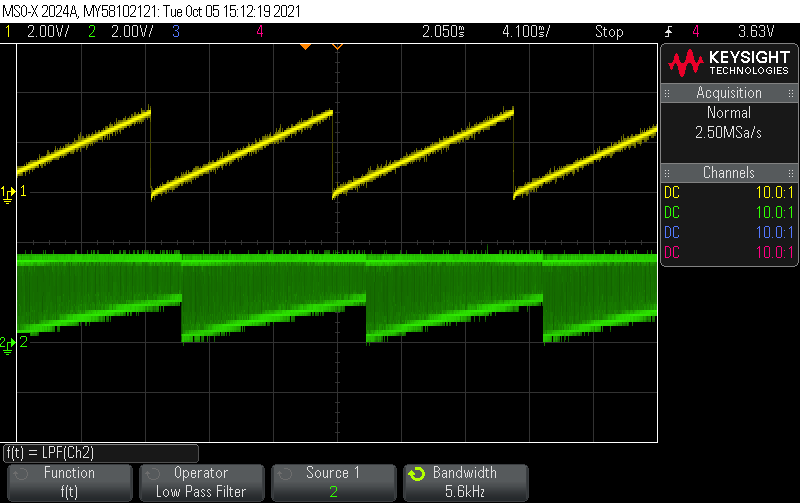

If it is not possible, could you zoom in the observed angle to see at which frequency it toggles to 0.
To be honest I have never seen such kind of shape before.

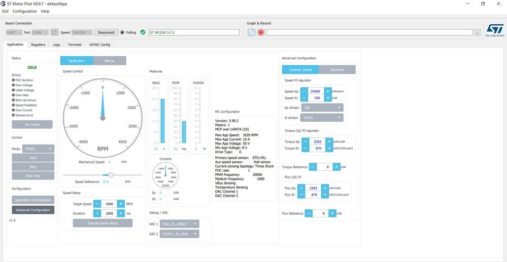

I used 5.Y.2 but still the signal is same. I hope the pin (PA5) in CN10 might get damaged.

Sorry, I was not clear enough. The purpose of switching to 5.Y.2 and the new Pilot is to be able to see these angles inside the mPilot, and not with the DAC output and the scope.
If you look at the top right of your mPilot screen shot, you have two buttons in the box "Graph and Record". If you click on the graph button, it will open a new window. If you right click inside this window, you will be able to select the signals you want to plot. (HALL_EL_ANGLE & STOPLL_EL_ANGLE)
With the new communication protocol we increased the communication speed so much that we are able now to dump FOC variables at PWM frequency.
It will at least remove your concern about the DAC output pin.
Before doing this, could you zoom in your oscilloscope to see at which frequency the HALL angle switch to 0.
