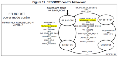

2025-05-27 8:04 AM - edited 2025-05-27 8:05 AM
Dear Umesh,
I belong to Application Team of Passive Safety group.
Here our feedbacks:
Yes, it is our suggestion to use a voltage divider.
VBATMON is used for power-up and power-down sequences, and ERBOOST enable.
It is also used to alarm the MCU in order to guarantee the correct functionality of RSU function.

You must use a resistive voltage divider to scale down your 28 V rail to a level within the recommended operating range of VBATMON (typically aiming for 12–16 V as a safe design margin). A buffer (e.g. op-amp or zener clamp) may also be considered depending on the precision and protection requirements.
For example, for 28 V nominal and 18 V max input:
Choose resistor values such that V_BATMON = 28 V × (R2 / (R1 + R2)) ≤ 18 V
This implies a ratio where (R2 / (R1 + R2)) ≤ 0.643

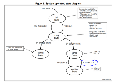

| ACL | Additional Communication Line – required to enter Arming State, as per ACLGOOD = 3 condition in Figure 9 |

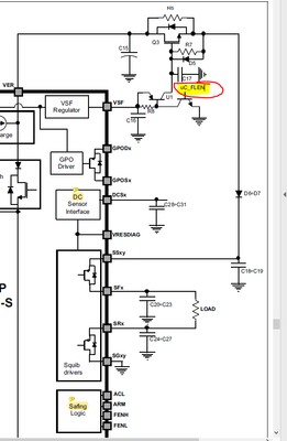

| uC_FLEN | In the reference schematic, uC_FLEN appears to be used as a GPIO from the MCU to control a FET in the VSF-powered safing path — is this correct? Could this function alternatively be driven by one of the L9678P’s GPO drivers to reduce MCU pin usage? (typically near U1 as shown in Figure 58) |

One more doubts as an application that does not use sensors, remote interfaces, or PSI5 input. Our use case involves triggering deployment logic solely based on MCU-driven signals, without relying on internal safing logic driven by sensor thresholds(we are not using in vehicle application).

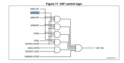

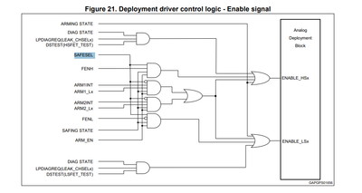

In order to reach the ARMING state and assert VSF_EN, as my understanding can we rely solely on:
ACL pin: 3 valid pulses (i.e., ACLGOOD = 3)
FENH pin: High
FENL pin: High
SPI SAFESEL = 1 (external safety logic)
And skipping:
All SPI sensor data processing
All safing threshold evaluations
SPI safing record logic
Since no sensors ( because external event has in MCU and based on that wanna to deploy )

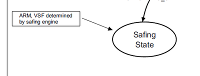

System starts in INIT → DIAG
MCU issues SPI command SAFING_STATE
L9678P enters SAFING state
MCU asserts:
ACL pulses (3x ACLGOOD vvalid)
FENH = 1, FENL = 0
SAFESSEL = 1
Device transitions to ARMING state
VSF_EN is asserted
Can you please confirm if this is the valid and complete minimal setup for entering the ARMING state when the internal sensor-driven safing logic is not used?
| ACL | Provide 3 pulses → ACLGOOD = 3 to enter ARMING state |
| FENL | Pulled high by MCU to indicate external safing logic |
| FENH | Pulled high by MCU to indicate external safing logic |
