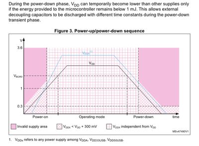

VDD above VDDA is no problem. The reverse is not allowed. You will need to ensure that the same order happens when they are powered down as well. A Schottky diode from VDDA to VDD will ensure this.
From the datasheet, ensure you are never in the solid pink areas.
This applies to STM32H7. Some other families are different.

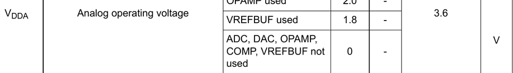

from H755 ds :
So Vdda can be 0 , if nothing used on analog supply...adc...vrefbuf.
So Vref+ can be same as Vdda , if all 0 V , is ok.
