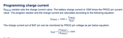

PC USB is 5V /500mA and STBC08 is 800mA standalone linear Li-Ion battery charger with thermal regulation ,
PROG pin connect res R2 is 2K, based on datasheet, recommend you modify this R2 value.

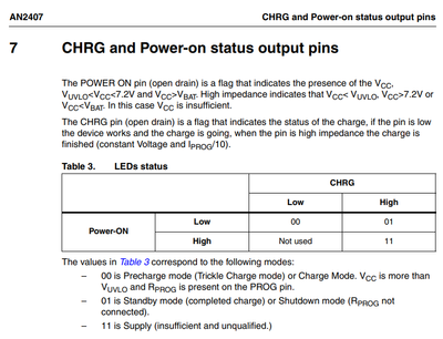

Based on "the two LEDs are light up " means 00 pre charge mode.
