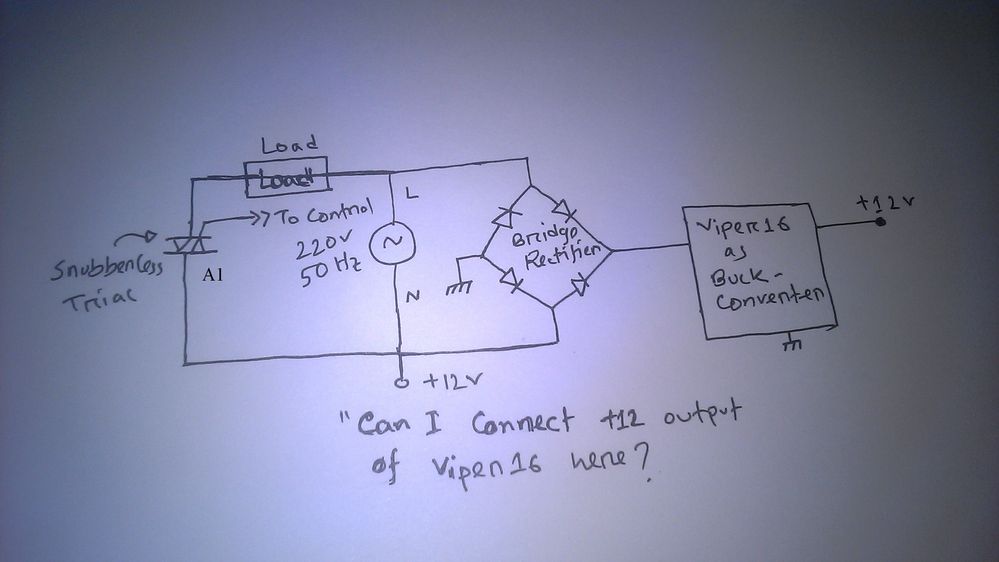

Hi
Can I connect the positive output voltage terminal of my off-line power supply using Viper16L to AC-main's (N) terminal (doesn't make sense though) to trigger a snubberless triac (T435-800T) as I drawn below. Is there any way to avoid isolated power supplies in such cases? Please let me know your opinion.

2017-10-30 1:26 AM
Hi Hasan,
Isolated power supply is not mandatory.
I don't know if your schematic is correct as you placed the label A1 of the Triac on the A2 terminal... If you want to trigg the Triac in QII and QIII, please connect the +12 V to A1, also referenced to Neutral. And connect the load between Line and A2.
All you need to know is in this ST application Note : AN3168 regarding 'Non-insulated SCR / Triac control circuits'. Especially section 2.4 for Triac triggering with negative gate current and section 3.4 for buck design.
An another usefull AN on this subject : AN4564 regarding 'Is a positive power supply mandatory for my application, or could a negative output work also?'.
Let us know if you have additionnal question.
Benoit
2017-10-30 10:16 PM
Hello Benoit,
I regret for my bad, label A1 of the Triac. To be honest, I didn't even know earlier that gate terminal should be drawn from A1 terminal. Thank you so much for pointing me out.
Yes, I found it helpful now. I don't need an isolated power supply but in order to trigger Triac in QII and QIII, I can do so with a non-isolated power supply and it should be negative one i.e. Buck-Boost converter for ease of implementation. Please correct me if I misunderstood something.
Nazmul
2017-11-02 5:23 AM
Hello Nazmul,
You understand well.
The figure 4 of the AN4564 is a easiest way for a non-insulated SMPS (buck converter), with the +5V connected to A1 for a QII/QIII driving.
Did your power supply only supplying the Triac gate ? If yes, you can have a look on resistive or capacitive power supply.
Benoit

2017-11-15 11:57 PM
Hello Benoit,
Please find my calculation regarding current limiting resistor, R10.
Worst-case Vdd (10% regulation of 12V) - VGT - VBE (Q1) 11 - 1.3 - 0.7
R10 = -------------------------------------------------------------------------------- = ------------------- = 180 Ohm
IGT (50 mA for safe operation instead of 35 mA) 50
Yes, it's better to count twice of the rated value for safe operation. Thanks for remembering me of that.
Nazmul
2017-11-16 11:48 PM
Perfect !!
Yes twice the IGT, because there is also a derating of IGT versus junction temperature (IGT higher at cold temperature).
