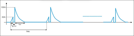

Your diode is used in the freewheeling path of a trigger circuit for a power semiconductor. The trigger current is totally 200A, per diode (two per TO-247 case) we have a peak of around 100 A. However, the pulse duration is only a few microseconds and will be repeated with a maximum of 1 kHz. This is how the waveform looks like:

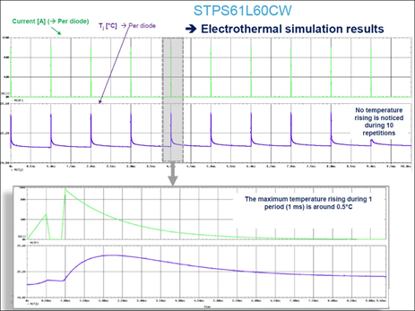

We have performed an electro-thermal simulation to check impact on temperature with repetitive pulses according to your requirements.
According to our simulation results temperature Tj does not increase by more than 0.5°C. Therefore you can safely use the diode under described conditions, without any risk.
