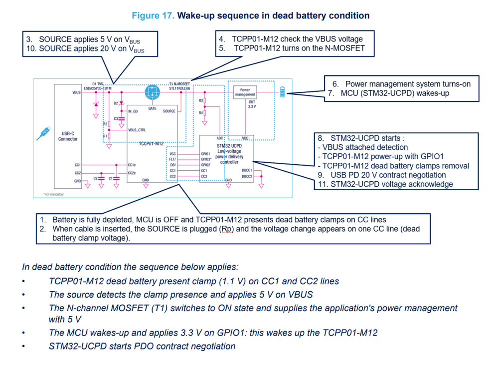

I have a technical question regarding the Dead Battery startup sequence. When the system is first connected to a charger and is completely unpowered:
VCC of the TCPP01-M12 is strictly 0V because the LDO hasn't started yet (the MOSFET is still open).
DB pin is also at 0V.

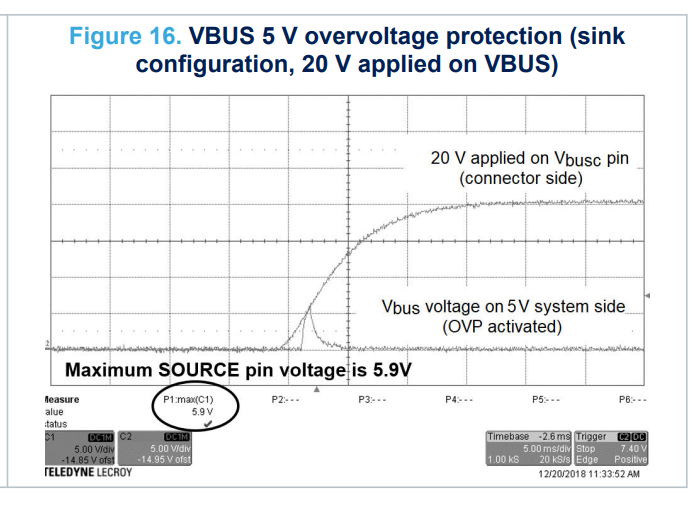

OVP Safety: How can we guarantee that the OVP logic is fully functional and capable of blocking the Gate Driver BEFORE the MOSFET closes, especially if a non-compliant 20V source is connected to this unpowered system?

2026-03-27 1:30 AM
start sequence is in ds ...:
OVP also shown:

2026-03-27 6:50 AM
Thanks for pointing that out! Those timing diagrams from the datasheet really help to visualize the sequence, especially seeing how the OVP is ready to block the Gate even before the system starts up.
