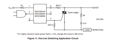

Mmmm . this is no good circuit for a triac . there are many couplers, to this job, ie. MOC3083 or similar.
with input current > 5mA (from your timer controlled circuit -> transistor out) this "MOCxxx" generates at zero crossing start pulse for triac - reliable. and low emission on mains...because zero crossing switching.
change your circuit...
