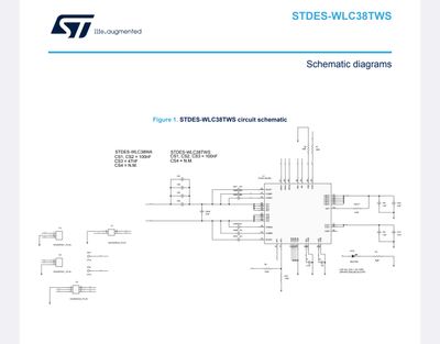

https://www.st.com/resource/en/data_brief/stdes-wlc38tws.pdf
Hi, we could communicate with the IC alright. However the charging is not happening although The wireless transmitter shows transmitting. In EVK the resistance is 100k.
Is insufficient power out may be due to this resistance?

In EVK the resistance is 100k. It is for enb pull down.
About insufficient power out , can you get some waveform on VRECT/VOUT pin, so we can have more detail information.
