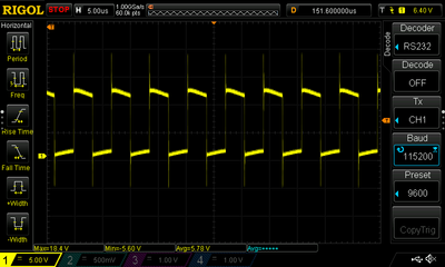

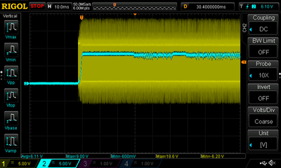

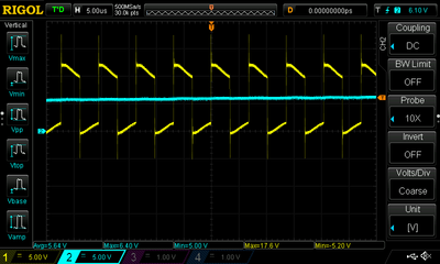

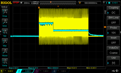

2024-07-11 3:45 AM
I have attached some images of my scope. Yellow is AC1 on Tx and Blue is RECT on the Recieve
