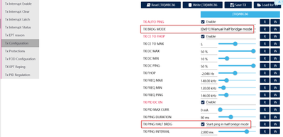

I've attached an image from WPSTUDIO showing the temperature reaching 100°C before shutting down and repeating this cycle.

1.For TX/STWBC86 12V input voltage, you must set ping in the half bridge, otherwise the energy will be very high for RX.
2.Also i suggest you modify TX/RX Ctank value. TX use 400nF and RX use about 152nf.

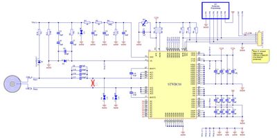

2024-07-10 7:50 AM
Show the schematic
2024-07-10 7:52 AM
2024-07-10 8:37 AM

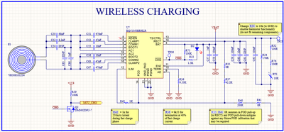

I have attached an image of the receiver.
The RX coil is PN: 760308101214, Ind: 26uH, Dia:17mm
The Tx Coil is PN: 760308101104, Ind: 6.8uH, Dia: 20.5mm
