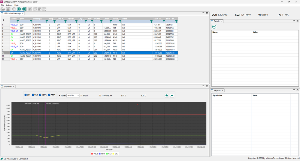

We are currently developing a couple of devices with USB-C DAM support and have chosen to use the STUSB4500 as the power sink on the device side.
We would like to understand whether the following behavior is expected, and if there are any options for managing or configuring it:
Using a custom debug board, we pull both CC pins high and then apply 5V power to the CC bus. Once this setup is in place, PD negotiation begins. However, we consistently observe a sequence of three Hard Resets initiated by the STUSB4500. This would not be a concern on its own, but during each Hard Reset, the STUSB4500 also toggles the nVBUSENSNK pin, which in turn enables downstream power for approximately half a second.
We’ve attached a screenshot from a CC protocol analyzer illustrating this behavior.
Could you please clarify:
Is this behavior expected from the STUSB4500?
Is there a way to configure the delay on the nVBUSENSNK signal?
Can the number of Hard Reset attempts be changed?
Or, does this indicate a potential hardware issue in our design?
We appreciate your guidance and support.
Best regards,
Andrius
CC pin analyzer
2025-05-22 11:56 PM
Hello
STUSB4500 sends HardReset because it does not see source_capability message. Thus it tries to 'wake up' the source by sending HardReset up to 3 times. If still no source_cap, it considered to be attached to TypeC only source.
There is no possibility to force VBUS_EN_SNK during this phase.
Best regards
