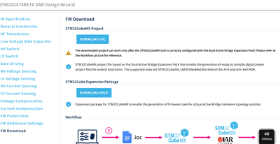

2025-02-24 5:47 AM - edited 2025-02-24 7:27 AM
Imagine my susprise when i discovered ST actually offers a DAB "software" for their 25KW evaluation board using stm32G474RE.
And i go to ST's website.
And the only downloadables are binary files and a lazy one page .pdf
Am i missign something here? where is the code?

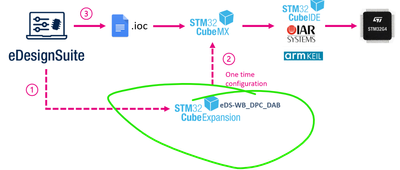

2025-02-24 7:41 AM - edited 2025-02-24 7:41 AM
Found it, it wasnt easy
https://eds.st.com/eds-console/#/digital-power-workbench/dc-dc/p/dab:dab:stm32g474retx

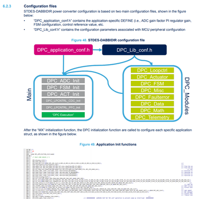

2025-02-24 7:07 AM - edited 2025-02-24 7:33 AM
I found this user manual UM3198
They are referring to some code stack i cannot find anywhere
According to the previous information, a CubeMX project with appropriate “config” and “init” are provided. Then
the required DPC module is included and configured.
Still no code on sight
