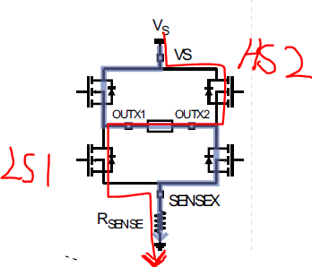

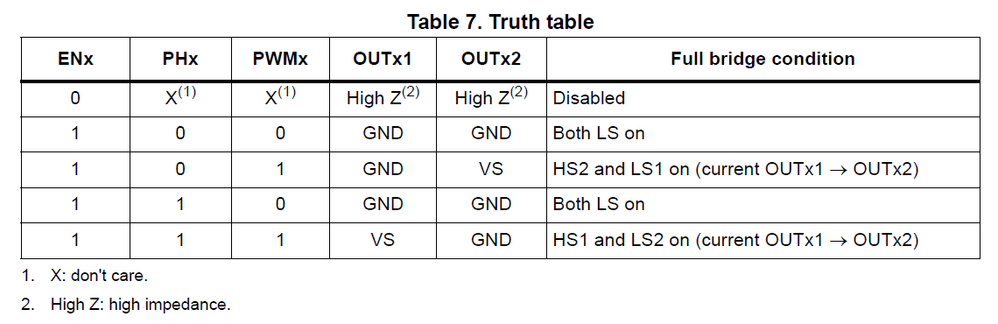

For PH 0 & PWM 1, is the current OUT1 -> OUT2 correct?
I think the picture below is an act for the above case.
If my guess is wrong, how do I rotate the motor in the reverse direction?

Hi @Minkyu Kim and welcome to the ST community !
Thanks for your remark, you are correct: there is a typo on the datasheet.
When PH = 0 and PWM = 1, the current flows from OUT2 -> OUT1.
The typo will be fixed in the next datasheet release.

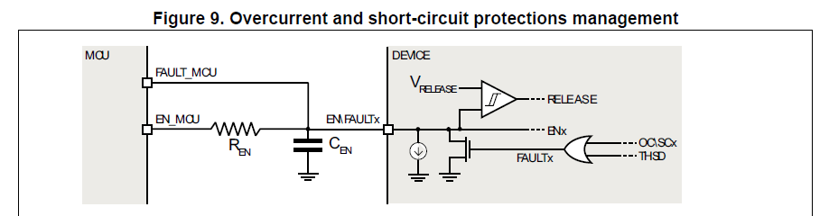

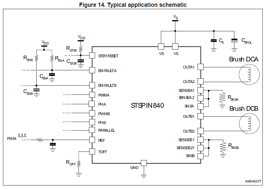

I have additional question.
Page 19 in datasheet, R_EN and C_EN's value are 39KΩ and 10nF.
In the graph that is the basis of the recommended value, the value of V is 3.3V.
Also in page 18, FAULT and EN pins in MUC are tied Driver's EN/FAULT pin.
And this typical schematic, each EN/FAULT pin's resistor is tied V_DD.
Do they have to be tied to 3.3V or is it okay to configure as shown in Figure 9?(In this case, VDD means the MCU's EN pin is 3.3V?)
A lot is difficult because it is the first time to design.
Thanks for your help.
Best regards,
Minkyu Kim.

Hello Minkyu, thanks for opening in another post the new question about EN/FAULT.
Here the link !
