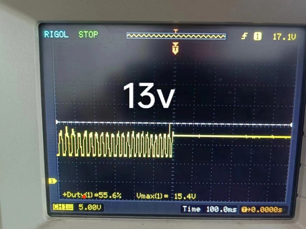

Problem Description.
After reflow soldering the circuit board, after visual inspection to exclude the problem of soldering quality, the power test on the tooling (DC 12V power supply, the output of the circuit board is not connected to the load). Output waveform is not normal, about 20%. Further test found that Vreg12 (Pin6) could not output DC voltage stably, and the phenomenon did not improve after adjusting the power supply voltage to 13V, meanwhile, the high level of HSU (PIN32), HSV (PIN29) and HSW (PIN25) output signals could not all bootstrap to 24V.

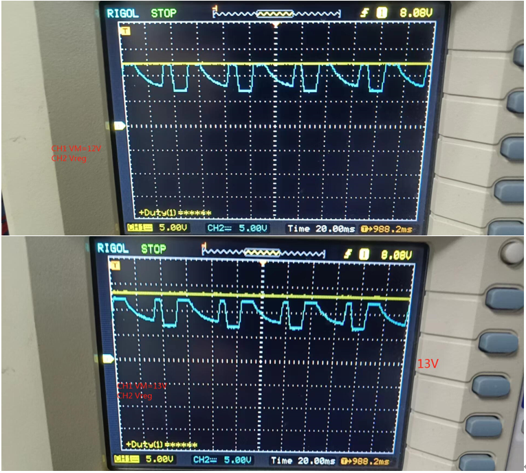

Could you show us the VREG12 and VM waveforms in the same screenshot?
If you do not share any application details (e.g. schematic) I don’t know how I can help you.
2022-05-17 7:05 AM
OK, I will test it and send it to you as soon as possible.
2022-05-19 2:14 AM
This is the waveform of VREG12 and VM.
2022-05-26 1:57 AM
Hi @Dylan.Dong,
from the VREG12 waveform it seems that the internal current limiter is operating.
You have to check in you schematic, what can be the root cause.
2022-05-26 2:04 AM
Okay, thank you for your enthusiastic help.
