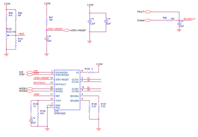

Thank you for your answer and question.
The current circuit diagram is configured as shown in the image below.
I entered the signals required for STSPIN220, but I am asking because the step pulse is not coming out.

2025-03-06 12:28 AM
The schematics look OK at first, but you can't see any capacitors on VS or the value of VREF.
Please check the orientation of the STSPIN220 to ensure that it has not been soldered rotated.
What signals are you connecting to the six lines on the left?
To be on the safe side, have you checked this with a known good board like the X-NUCLEO-IHM06A1?
Regards

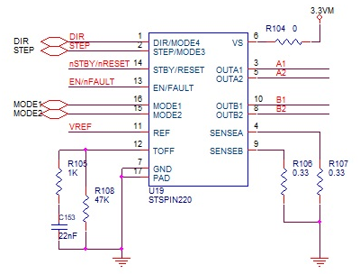

2025-03-06 5:39 PM
Thank you for your kind guidance.
We are sending you the information about 6 signals and additional circuit diagrams.
We has not verified X-NUCLEO-IHM06A1.
We are contacting you urgently because the development schedule is very urgent.
2025-03-11 7:14 PM
After modifying the resistance values, I confirmed normal operation.
1. R108: 47K -> 10K
2. R106, R107: 0.33 -> 0.2
Can you explain the difference?
