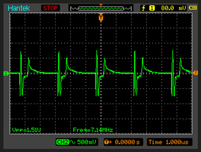

Thank you for your precious answer. I didn't think this could be that serious. Here are the measurements between AGND and PGND:
This is taken when the L6981 is in 2.5v state. (trying to boot I guess):

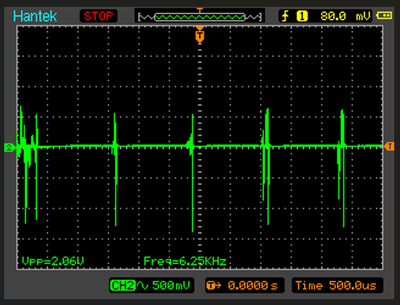

And then I shorted the bead and saw that L6981 finished booting. After this L6981 started to work normally. While bead is not shorted anymore. This is taken when the device outputs 5.0v:
I think the fix is to remove the bead.
