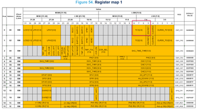

I just found out that the register 0x00, ENVREF1, and TC1 are always reset to zero. Any idea why?
