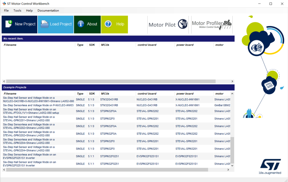

Sorry I did not find the firmware example in X-CUBE-MCSDK-Y. Can you help me find it? Thanks.

Hi @Dylan.Dong which SW version have you installed?
The STEVAL-PTOOL1V1 is supported by Rev Y 5.5.2 and following.
