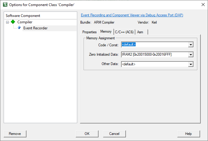

I have a project with the ST32L476-MCU, developed with RTX5 and the CMSIS RTOS2 on top.
I want to implement the Event Recorder, and have followed this link, but as I try to build I get a warning, as stated in this question's title.

The only way for me to get rid of the warning, is to set the Memory Assignment for Zero Initialized Data for the Event Recorder under "Options for Component Class 'Compiler'" to <default>, but this is not a solution to the problem, as the memory wont be assigned to the new allocated IRAM2 of course.

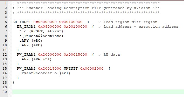

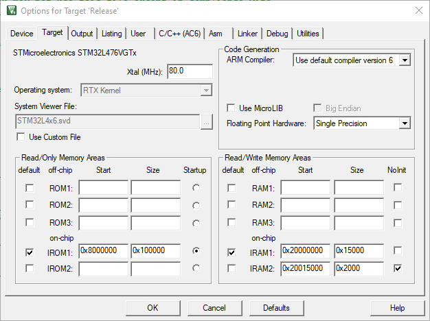

Hi Tesla,
I just don't understand why no section would match the address I've set for the EventRecorder? I've tried to use the space for SRAM2 according to the ref. manual (0x10000000), and I've tried to reduce the size for IRAM1, and use that space to IRAM2 instead, but no matter what, I'll get the warning that the section doesn't match the EvenRecorder??

I ran into this exact issue after upgrading Keil MDK/uVision from v5.31 to v5.37.
Does your build output window show this line:
Note: source file 'C:/Keil_v5/Packs/Keil/ARM_Compiler/1.7.2/Source/EventRecorder.c' - object file renamed from '.\Objects\EventRecorder.o' to '.\Objects\eventrecorder_1.o'.In order to explicitly place any renamed object, I used a wildcard matcher by specifying "EventRecorder*.o (+ZI)" in the scatter file.
