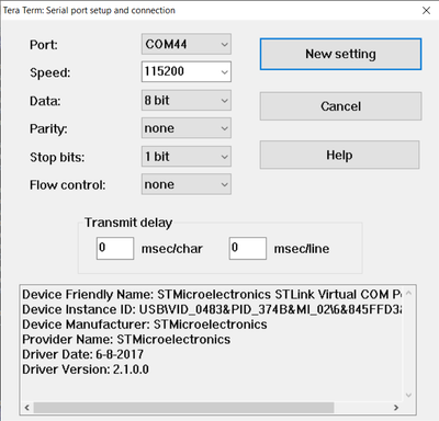

When testing discovery kit. With Demo 1 binary file FW of the STSW-L9961BMS. Tera Term serial monitor outputs random characters. Using Speed 9600, Data 8 bit, Parity none, Stop bit 1 bit. Tried different computer. Tried different settings. Same result. Display nothing like VT100 User Interface.

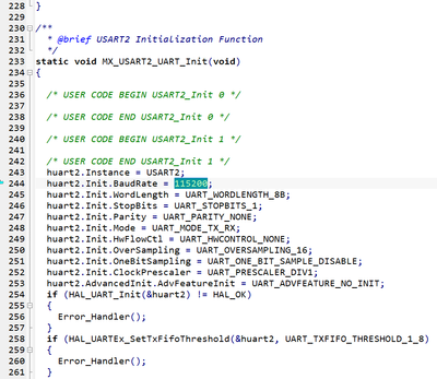

sorry for the delayed answer.
Did you try to set UART baud rate at 115200 ?
It should be the right one.

2023-12-15 1:40 AM
Ciao KWarr.1,
it seems that the problem is due to a wrong UART baudrate setting.
Please, cross check the suggested values, so as reported within the source code and the snapshot.

2023-12-15 3:01 AM
When I select 115200 baudrate, I get a flash error massage NO DEVICE FOUND from Tera Term VT.
