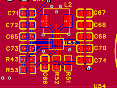

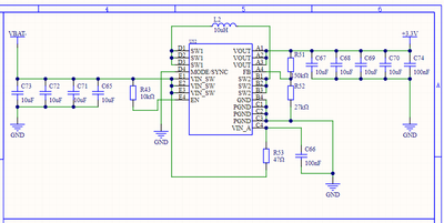

2023-12-19 3:41 AM
ok, below is the schematic and layout.
2023-12-19 7:36 AM
Schematic and layout look good.
Now the type of the 10µH coil L2 would be important. However, the value of the saturation current of L2 and the flowing load current are also sufficient for me to assess the suitability of L2.
