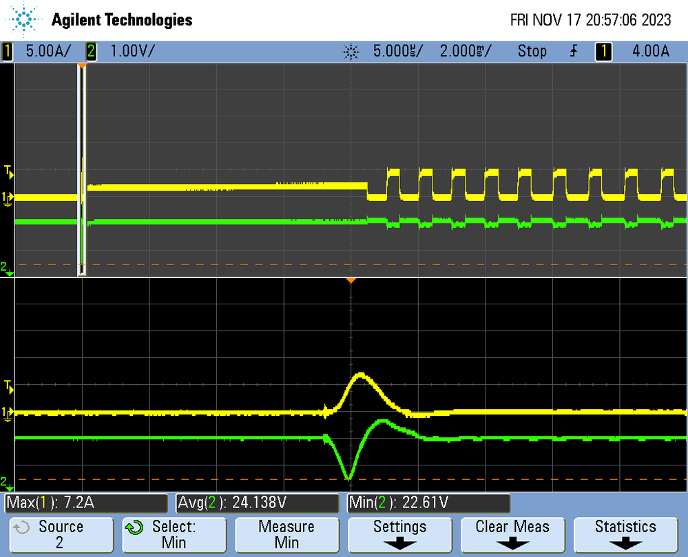

Finally i owned the STEVAL-EFUSE01 and measured what i needed by myself. Setup was a 24V 10A PSU, unmodified evalboard, auto restart jumper inserted. Current probe was 50mOhm shunt. See the picture below. It is a input current (yellow) and input voltage (green) while STEF01 output short-circuit. Short-circuit peak is nice limited to 7A, reaction time is in microseconds. After 8ms thermal protection start to cycling the output current. Hope it will help someone.

2023-11-17 12:26 PM
