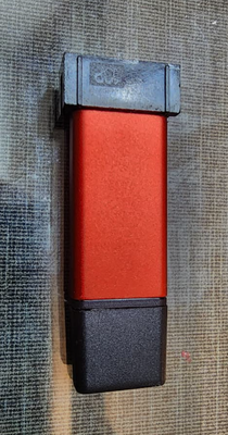

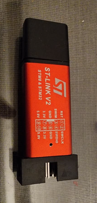

2026-04-16 3:59 AM
Welcome @ploopy246, to the community!
please upload photos of your ST-LINK/V2, front and back.
Regards
/Peter
2026-04-16 4:07 AM
@Peter BENSCH wrote:please upload photos of your ST-LINK/V2, front and back.
@ploopy246 I think Peter is hinting at this: How to recognize a genuine ST-LINK/V2 versus a cloned one
In particular, these are fakes.
See also:
How to solve connection errors when connecting and programming the STM32 target board.
How to solve debugger connection issues
2026-04-16 7:24 AM
Thank you! I genuinely appreciate the help. These are the ones I had purchased
Any guidance would be helpful
2026-04-16 7:26 AM
Thank you for the response! I'll look into the links provided, hopefully will come to a fixable solution in the whole process; this entire time I was confused as to whether it was the ESC itself, or my poor soldering skills were at fault XD
2026-04-16 7:51 AM
So, as shown in the link I gave, those are fakes - not genuine ST-Links.
There is no guarantee that they will work properly - or even at all - with the ST Tools.
Do yourself a favour, and get a genuine ST-Link.
Buy from an Official Distributor to be sure - not Amazon, ebay, Ali, or the like.
2026-04-16 8:53 AM
I definitely will! Thanks for the guidance, genuinely appreciated :)
