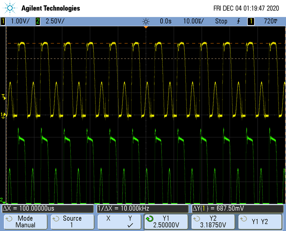

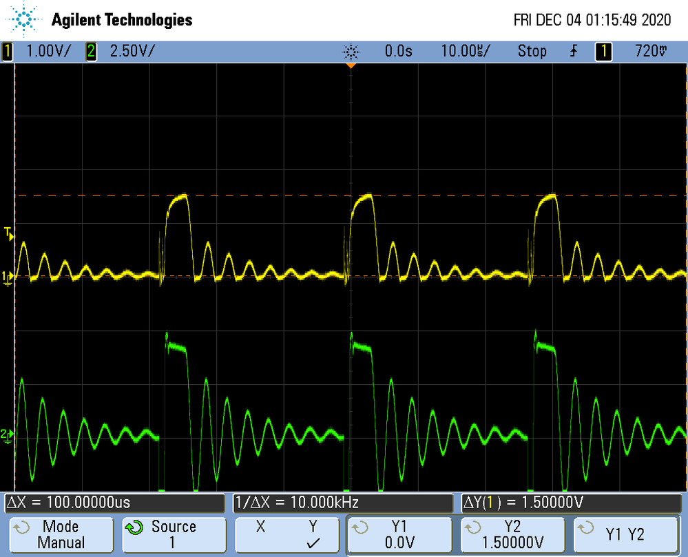

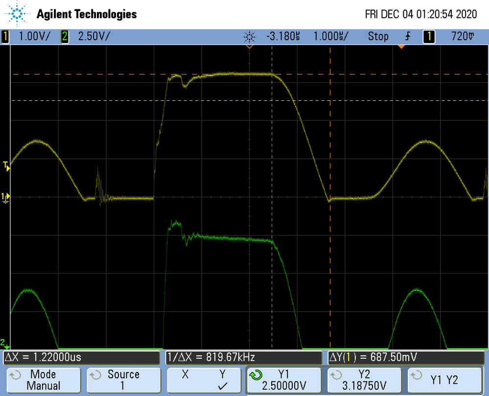

I'm testing a simple flyback converter using the STCH03L. All seems as expected, however I can not seem to get the IC to detect an overvoltage condition. To conduct the test I am simply shorting out the optocoupler. When I look at the ZCD pin the reflected signal clearly goes full scale. i.e., clamping at both -60mV and +3V. At the point of demagnetisation the peak that occurs just before the aux winding collapses is hard up against the upper clamp. The slope of the collapsing current takes just over 1uS before the signal passes the +60mV demag. trigger point. This repeats continuously, but the IC does not trigger a fault condition.

Single cycle OVP
OVP across several cycles
Normal operation several cycles.
