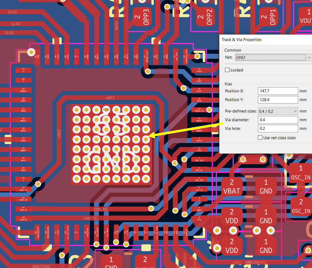

We suspect a problem during assembly, although the technician has experience with QFN / SMD soldering (and with DRV8323 there were no such problems). Or the problem with damp chips. Or possibly poor layout, due to generic centerpad footprint (autogenerated by Ultra Librarian) - lot of tiny vias, that come out "blinded" / impermeable, no air will pass, let alone the tin, I attached cutout picture of what I mean:0693W00000LxZWsQAN.png0693W00000LxZerQAF.pngPCBs were mnfg by JLC.

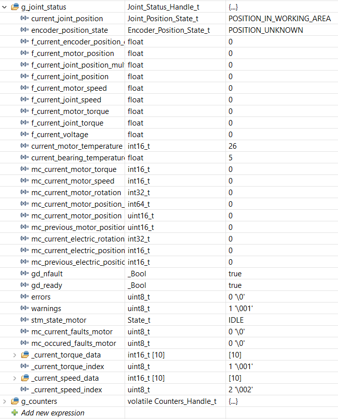

Here are status registers, before starting motor, so g_fsm_status:state is FSM_INIT
0693W00000LxpwmQAB.pngOn this particular board, motor won't start at all, even tho gd_nfault is true (so correct), no error occurs, and stm_state_motor is RUN. On other boards, there are indications, that there's some problem, like false-positive "error 64 - overcurrent" or gd_nfault == false.

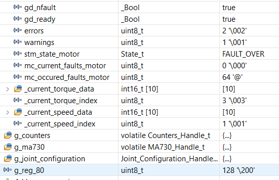

Ah, okay, using this code:
HAL_I2C_Mem_Read(&hi2c3, 0b10001110, 0x80, 1, &g_reg_80, sizeof(g_reg_80), 100);
I'm reading STATUS register with result of
0693W00000LxyupQAB.pngOn this particular board, error 64 occurs right when encoder aligning begins.
Hi @KKost.3​ from the device STATUS register no fault event is occurred in the gate driver.
It seems that internal comparator is triggered causing the spurious overcurrent error.

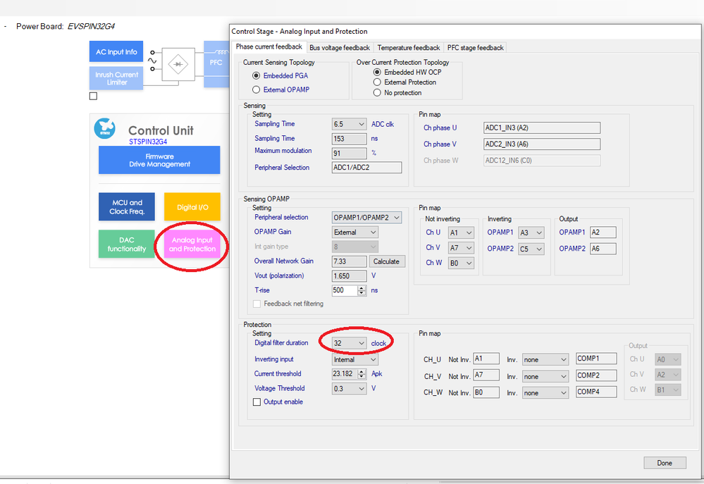

Assuming this event is caused by noise on the comparator, you can try to reduce its effect increasing the duration of Digital filter (refer to following figure:

Hello, @Cristiana SCARAMEL​. Thanks for helpful answer, tho actually modifying Digital filter duration didnt help us, setting "Over Current Protection Topology" to "No protection" did make our boards working. And now every board that had error 64 works. I know this is only bypass, not a solution.
