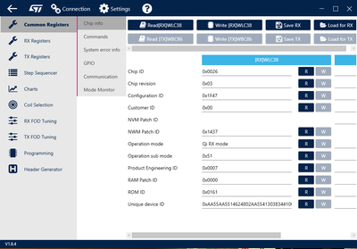

4.What is RX fw version, please give below picture to me.

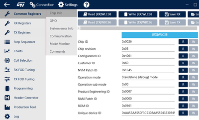

4. My Rx fw version is:
5. The wearable will be a small watch, but we have not built it yet. We are experimenting with the evaluation boards to finalize the design.

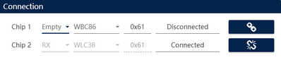

You can use "Empty" to connect again.
2024-03-29 12:29 AM
Unfortunately "Empty" does not work.
It is not wrong config id or patch. It is like the WBC86 is not there at all.
Maybe it is not damaged because it is still transmitting power for a while, but I cannot connect to see any information.
I suspect that the problem is in the USB/I2C bridge.
