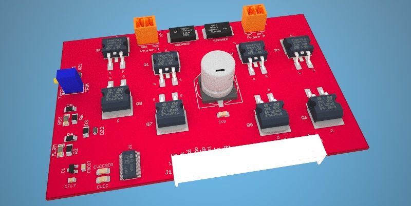

I have designed a board using a L6482 chip.
My L6482 has started, and I can send and receive messages a través de SPI bus, but now I have a problem: My STATUS register says:1110 0000 0000 0011
(Get Status Command = 0xE003). It means:OCD
= 1 --> overcurrentBUSY
= 1 --> StoppedHiz
= 1 --> Bridges in High Impedance State.The problem occurs
even
without connecting the
steppermotor.
...! Just turn on the power, and my L6482 gets quite hot, but I have measured the total current of the board, and it is only 0.1 Amp.Configuration:
I have read AN4354 and UM1685 Application note and User Manual, in order to calculate config values of my board: OCD_TH = 1000mVTCC = 1200 nSg
IGATE = 64 mA TBLANK = 500 nSg TDT = 250 nSg I use 3.3v external power supply: VCCREG, VREG and VDDIO are connected to this 3.3v external power supply. I use VSREG and internal regulator for obtaining VCC=15v. VCC pin is unconnected. I am using Mosfets STB75NF75L with D2PAK package, of ST Microelectronics manufacturer. My Rsense =200mΩ
, is it a too high value? So I think the problem could be:Bad values in registers of configuration. (AN 4354, chapter 2.4: Too low gate charge to complete the Miller plateau region...?)
Bad connections of: Vs, VSreg, Vccreg, Vcc, Vdd, etc.......

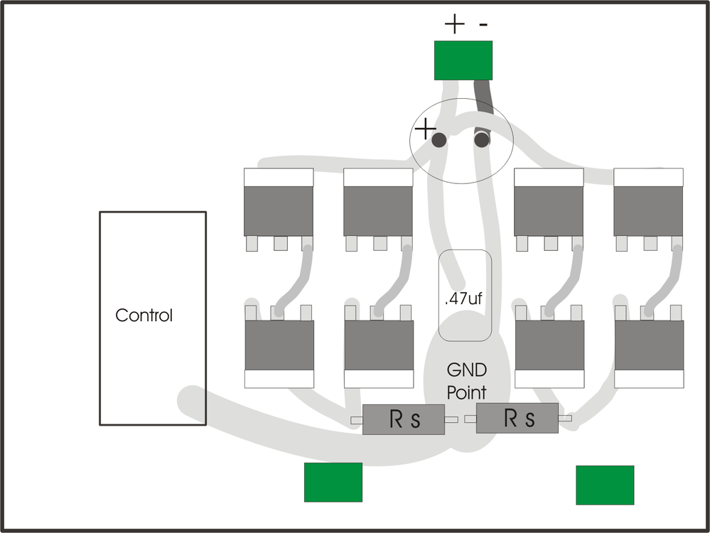

Ramirez, the problems you are having are most likly your PCB layout. Having your mosfet place around the board with the control chip in the middle will cause al kinds of stray current arround it affecting the operation. Yours may look like the eval board, but they may have a hidden layer just for the high currents. Also your main capacitor and incomming power is off to the corner far away from the other bridge, so the path lengths are different.
I suggest to put the bridge and input power on one side of the pcb, with a common ground and power point exactly center between the 2 bridges. Your 2 sense resistors should connect there and the main cap and bypass cap (.47uf 100v poly) should be all there in a tight close power point between the 2 bridges. Then beside the power section put the control L6482 with a thick ground pad going over to the star gound point where the power and sense res connect. Thats the only place where all grounds come from for all inputs and power. You can actualy get good results from a 2 layer properly layed out hand routed pcb, than a poorly layed out 4 layer.2014-06-30 3:44 PM
Here is a mockup of a layout used in some commercial drives. Also you could put an on board fuse to protect the motor, incase all else fails.

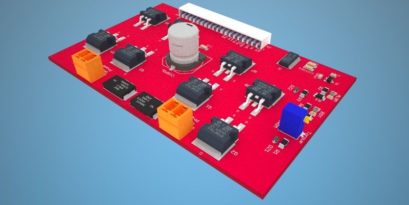

2014-06-30 11:18 PM
Thank so much , Kenny for your support,
I think your proposal could be something like this:2014-07-01 12:13 AM
I found
another significant difference between my pcb board and ST designs:
In my boards:With Mosfet
STB75NF75L it is necessary a Total gate charge: 75 nC V at 5v
With Mosfet
STB80NF10T4
it is necessary a Total gate charge: 135 nC V at 10v
But in ST design (see EVAL6482H-DISC) they always use the lowestTotal gate charge they find:
With Mosfet
STL40N10F7
it is only necessary a Total gate charge:
14 nC
V at 10v That way, it is easier for L6482H driver to switch on this Mosfets.2014-07-04 1:31 PM
